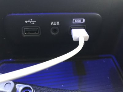

Thanks Mike, That's a relief. You are the MAN as always. :)
Me personally. I like the idea of only having one plug for media. Cause I don’t want my wife plugging her phone in and it trying to do Car play for both phones. She can charge hers and I can use mine for music messages nav.

It doesn’t matter which side it is plugged into. You will not be able to use car play or media via usb with the pictured hub.
Mike G will have to let us know.
I have the same hub but the side your cord is in is charge only. I will be doing the upgrade middle of next week and guess I will find out lol

Like Paul said, the right side on that hub is charge/pwr only. You need to plug the phone into the one on the left.
M² Mods.
Can you verify this? I did my upgrade from RA4 to UAQ today and everything works fine except no response from the hub, either under media—>Usb or car play. On either port of the hub though it does charge.

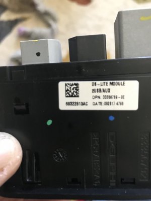

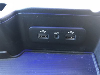

View attachment 143913 Note on 2018 Ram media hub. I have a 2018 Ram 2500 that came with RA3. The media hub was not car play compatible. I’m not sure what the part number is as I haven’t swapped it yet. Notice the icons above the USB ports are different than the 68328704AC.
Just wanted to let you know in case you are looking in salvage yards.
I have a coworker that has a 2018 2500 tradesman that installed the UAS radio and the media port works for CarPlay. He did not swap hubs, and he has the same hub you have pictured. What is the part number for your hub you currently have? I’ll see if he’ll get the part number off his.

Ok so here is the deal, I installed the new hub today and everything is working. So for all you arrogant know it alls, it will pain you to know that you are WRONG. The hub that came in my 2018 2500 is not compatible with car play. So not ALL 2018 hubs will work, for those of you looking in salvage yards.
The part number of the OEM hub that was in my truck ( from the factory) is 68322813AC. This hub does NOT work.
I replaced it with the 68328704AC today and boom everything works.
I wish people on these forums would check their ego, no one person has all the answers.
Not sure why you’re getting all bent out of shape? That is the same part number on my coworker’s truck and CarPlay works with it on his UAS radio. We’re not questioning you because we don’t believe you, it’s because we can take this information and compare it to figure out WHY it works for one person and doesn’t for the other.
