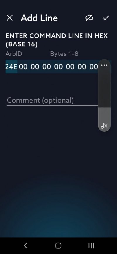

I'm trying to fix the heated seat issue with my 16 as well. The Auto Agent app does have the ability to send a can commend (that I can set) as well as frequency of occurrence. Would that work for sending the correct message to let the radio know the engine is on?

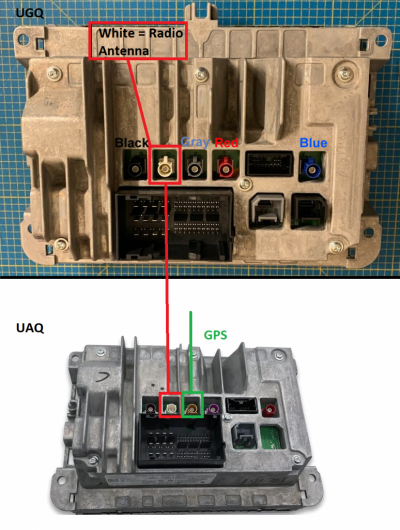

I am upgrading my Harman VP4 radio to a Panasonic 4C-Nav on my 2014 Dodge Ram 1500.
I installed a UGQ (Europe) ref 68289301AH
I have a problem to connect the GPS antenna.
The colors and connectors are not identical between UAQ and UGQ.
What is the color correspondence for the GPS connection?
On the same location as on UAQ?
On my vehicle I have two cables:
- One white for the radio antenna
- One olive/green for the GPS
Thanks for your help
