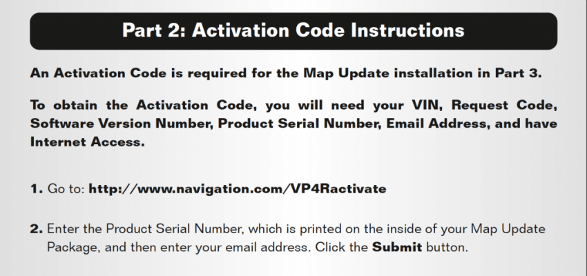

I recently upgraded from the 5" to 8.4 with navigation in my 2016 Ram, it's one of the Panasonic 4C models. I purchased the 2022 map update from Chrysler just now. (I know most consider it a waste of money, and yes I can use Waze, etc. but I like the turn by turn in the cluster... shoot me). To order the map update I just needed the application version from the radio. But when I looked at the installation guide, in order to finish the map update it's going to make me put in a VIN#. I have no idea what the donor VIN was. I read somewhere that the dealer can update my build sheet to reflect the new radio? Anyone been through that process? Is there anyway I can get that done without the dealer involvement?

I have been told by my others (with Prior prior ra4s like @Ricks Ram) that you use the vin of the vehicle it's currently installed in for map updates.
(Donor vin needed for radio SW update files)

Well from reading the installation guide it sounds as though you get one or two usb drives with SW updates and then another with the map updates.

So I'm a little confused @Mpgrimm2 about the map update @bretthays wants to do to a 4C radio. I see the update purchased is listed as VP4reactiate. I thought all the the 4C updates were only available OTA. Did something change, I'm at v19 whatever and I'm good with that but new maps would be nice.

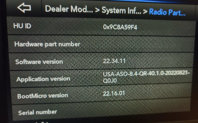

Awesome. Thanks. Everything must have finished loading last night because it's all working now. Looks like I have SW Version 22.34.11. I've written to Chrysler but figure folks here probably have a more accurate answer. How do I get the SW updates? Their site requires a VIN but mine would be associated with the old head unit. Really appreciate all the help.
The Panasonic radios go by the application version...
You're on v40.1.0 which is the newest version I've seen yet (v39.9.x was latest until yours)

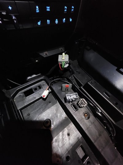

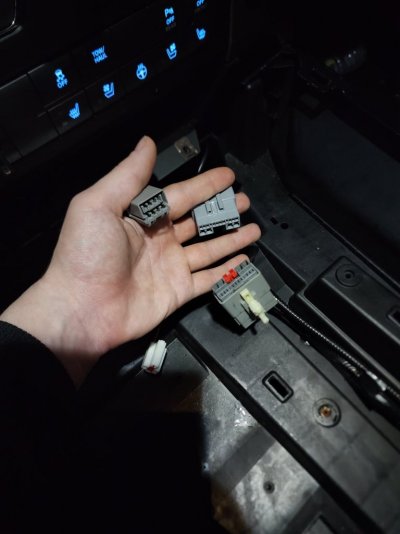

Just got in all the connectors I need for a second KEYED media hub with illumination
Once I have time to get all the wiring done and get a second media hub to test, I'll post the links to all connectors used, which hub I used and wiring guide to make your own.
The second hub will go in the center cubby area, like in the fifth gens, underneath the phone holder to allow for a tiny USB cable used for Android auto/apple car play.
Also this will bring support for the option to make the other USB hub keyed only as well provided you spend the time adding the pins to the other harness.
