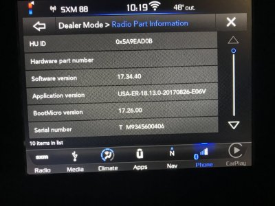

Hope this is what you are looking for. Everything works now after the hub replacement.
3542078E-94A4-466E-8773-AF393E3327A1.jpeg 8F05F345-3865-4B00-B7B6-8DFE5CF92715.jpeg

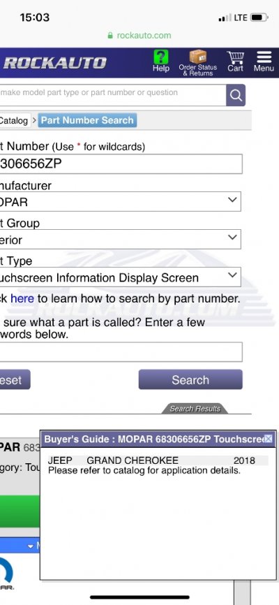

That (68306656) PN isn't one of the 2 USA ram UAx Radios listed in the Op and may be a reason why it didn't recognize the ram USB hub (driver difference perhaps). Do you know what vehicle line it came from?
Can you tell us what the application version is if the radio? 18.2 ; 19.9, 21.9 etc?
M² Mods.
That part number matches up to 2018 JEEP Grand Cherokee UAx radios. That’s a good thing to know if that’s all you can find but it will cost you an extra $100 for the upgraded hub

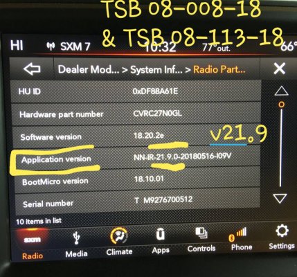

This will help from the recent uConnect v21.9 update thread...
Fyi,
Dealer's just got issued TSB 08-113-18 to allow them to download/install v21.9 "application version" on 2018 UAx 8.4 Radios (not 13-17 8.4 radios, those are at 17.43.x).
Here's the actual TSB which won't help those of you that already have it OTA.View attachment 140035

Hold temp up + temp down + front defrost buttons for 10 secs to get into dealer mode. Then you can check the "application version" to see what you have.

Ok so I was looking at the wrong screen for version info. Here you go. I guess OTA isn’t working for me but the WiFi for sure works. Strange!

Ok. Your 18 Cherokee UAQ is on v18.13.
The nearest ram version is v18.18, then 19.9
I can see about getting you the 18.18 if you want.

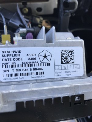

A buddy of mine picked up a UAQ PN 68306656.(Grand Cherokee)
We put it in my truck and in his and neither would work with the standard media hub in either trucks. Both 2018.
We swapped the media hub in his truck with the dual USB port media hub and it worked flawlessly. His firmware is 19.9. I did a test install of my UAQ 68331631 in both trucks and it was plug and play and the original media hub 1 media usb 1 power usb works with no problem.
Must be a Radio driver issue that it can not sync with the stock media hub on Rams cause it’s designed for Grand Cherokee media hubs.
The 1 2018 Grand Cherokee I seen at the dealer the other day had the “upgraded” media hub that has dual media USB ports.

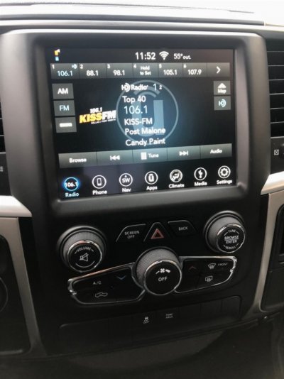

Finally had some time to do my conversion. All finished finally.
2018 Black Pearl Ram 1500
LED Tail Lights, Black 4 Quad Halogens with HID conversion, LED Black 3rd Break Light, Blacked Out Emblems, 8.4 UAQ conversion!

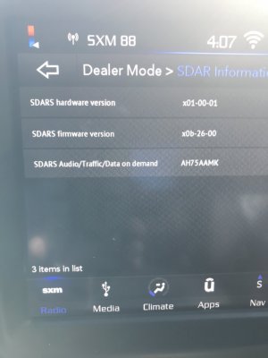

I got it to work apparently. I haven't been in my truck much this week, but I was finally able to pull up the SSID and got my phone to pull up the ATT.com/fca landing page. It did show the old VIN number though. I'm not sure if it will work if/when it pulls in my VIN number or not. Might be worth it to someone to try if they want decent WiFi.
If you go into dealer mode/system information/Connectivity the radio will show you the IMEI number just like a phone. I’m just assuming here but I’m going to test it out by calling at&t and seeing if I can get it activated using that number instead of the Vin since my truck did not come with the UAQ.
