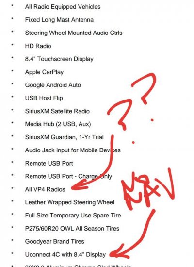

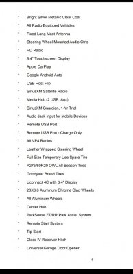

I got the build sheet for this truck.
It says 4c radio but also says "all vp4 radio"
The listing for the part says it has nav built in but I cannot find it on the build sheet and the only photos of the radio don't show nav in the menu (on the new radios you can move that menu around though so it may not necessarily be there but have it installed?)

I would say get the actual part number from the radio. Have them send you a Picture of the label And compare it to this thread to confirm Nav. People do lie and try to rip people off. You want 4c-Nav. Or UAQ. PN - 68331631xx. There is other UAQ radios that work but that is the Ram radio PN

I've asked them for a photo of the apps menu or the settings page with the pn on it .In the photo of the radio it's powered on and is definitely the 4c since it has that look to the menus and the bold text of the font where the temp and time is etc. I'll see if they get back to me on a saturday

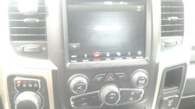

Does this menu look right? This is the unit I was looking at. Idk if you can change the menu appearance or not? It just doesnt look like all the other photos of the 4c's ive seen. I want to get it so I don't lose out on it .

Just remember it takes a couple of key cycles and a little time for all of the features and screens to get setup. MY UAQ took a a couple of starts and overnight resting before everything came up like it should.
Can't tell from that picture is it's a 4c or 4c Nav radio. Only a few ways to know... Pull the radio to get the PN (best way); pull up the apps menu to see if the Nav icon is there (could have been removed from the main menu by user); or check the original VIN/build sheet
Pm me a link and I will see if anything else let's us know

@icetraxx That's from the donor vehicle on the parts site.
@Mpgrimm2 I pulled the build sheet and this is what it says .I also sent you a pm .I know worst case scenario I end up with a uas which I still wouldn't mind.

Looks like it's most likely a UAS radio...
"uConnect 4C with 8.4" Display"
(vs uConnect 4C Nav with 8.4" Display)
