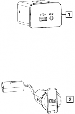

Has anyone noticed when they search for 68328704AC online you get this schematic for the part from some of the Mopar part retailers? Is this the original rendering and it's changed since then to what we know to be the dual usb with aux in the middle? Or is this actually in production now also?
Dual usb with aux is the new production model for 4th Gen
