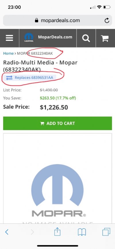

Part number was replaced. Updated part number in picture below. 68322340. Reminder AC/AK/xx. Just different revisions same radio

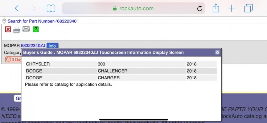

Rock auto had this replacement Radio PN in picture below. They provide confirmed vehicles that these are found in

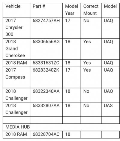

DeereGuy pulled the following PNs during early testing of the various UAQ radios when trying to locate them ... Looks like Lawsuit11's info matches DeereGuy's list also (don't mix the 531 up with the 631 ram PN). ** Challenger mount should be different unless the case was swapped.

The case is definitely the same. I'm wondering if they changed that out since the seal on the unit says mgsales xxxxxxx and the seller was "mygigsales".

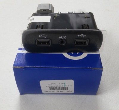

Quick question: the parts place I ordered the new hub wants my VIN to assure the correct part is ordered and shipped (because there's no returns, apparently).
I just want to verify - the part I ordered is the one that was posted to order: 68328704AC. This part number directly correlates to just one part, correct? And that part is this one:
Just tell them it’s a upgrade no vin needed and yes that is the correct PN
