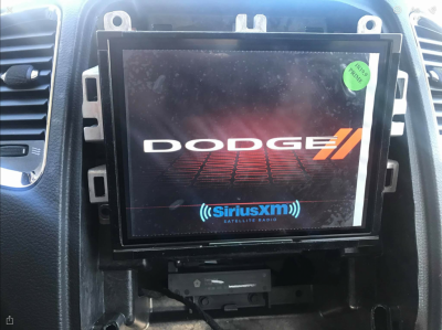

Dodgetk81
Jan 31, 2016
456
144

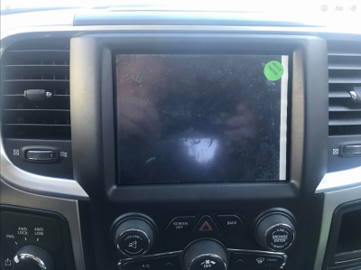

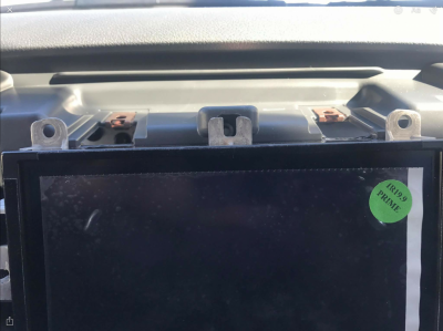

E13ACF75-F755-4F5E-ADBD-68F2D8245BC6.png BFF06F15-CC10-4555-A596-577D2E4F99EE.png I tried a UAQ radio from a 2018 Durango in my UAS equipped 2018 2500 and it did not work. I have an 18 Durango with the 7” screen and it works in there with no issues. I’m wondering if the bcm has to be set to UAQ or something? I know others have installed in older trucks with no issues, I’m wondering if this is 2018 related. But on a side note, the tabs from the Durango radio don’t need to be cut. I put the radio in and put my bezel back on with no issues. I would get a self driller and catch the dash plastic for the top holes. There is something to catch in about 1/2 of the hole. Below are some pics of it in the ram, and powered up in the Durango.

CuylerTech
Nov 30, 2013
3,633
961
NH
2015 Big Horn Mega Cab 4x4
6.7L
View attachment 123067 View attachment 123068 I tried a UAQ radio from a 2018 Durango in my UAS equipped 2018 2500 and it did not work. I have an 18 Durango with the 7” screen and it works in there with no issues. I’m wondering if the bcm has to be set to UAQ or something? I know others have installed in older trucks with no issues, I’m wondering if this is 2018 related. But on a side note, the tabs from the Durango radio don’t need to be cut. I put the radio in and put my bezel back on with no issues. I would get a self driller and catch the dash plastic for the top holes. There is something to catch in about 1/2 of the hole. Below are some pics of it in the ram, and powered up in the Durango.
Not sure why that one didn’t work. Current one in my truck is a Durango radio and works 100%
