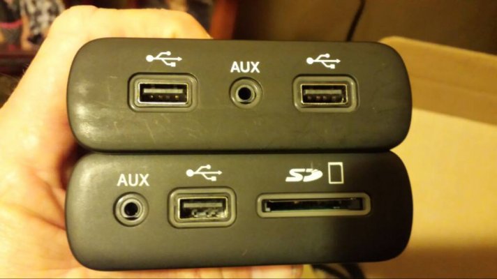

Yes you will, Unless you can live with some stuff being "off". The Ram USB Ports have 2 USB now instead of one, so the BCM needs to be corrected to tell the radio it is 2USB + AUX not USB+AUX or USB+SD+AUX. If you do not currently have an RA4 Radio, then travel link will not work either.

ECU 3 External Port Type is what Drives what Options are shown under media on the radio.Both usb ports will work yes, but the if you had a SD card reader before it'll still show under Media even if the SD card hub is not installed.
Options are:
Absent
AUX Only
AUX + USB
AUX + USB + SD
AUX + USB + extra USB
AUX + USB + SD + Extra USB
None Used.

OK I got my SD/USB/AUX hub today for the 17 Challenger Part# 68294633AB that Cuylertech referred too, plus my harness from M2mods arrived today as well. Absolutely beautiful work guys as usual! The hub appears to be the same size as the Ram UAS/UAQ hub so I am hoping if I can find the storage bin for an 18 Ram this hub should be a direct fit. My truck came with the RA2 but it shows the SD card option on the UAQ/UAS radio because I actually activated the code in my BCM. I'm hoping it will work. I might try to install it tomorrow depending on the weather. I am borrowing STecoD's spare UAS until my UAQ gets here just to test and see how everything works. I will report back with any information. 2987a7cf1c99b1a02afee329ec266159.jpg83510fe20a4e2cdf2b0aea1df032aaf4.jpg

I wonder if I would like the double usb or the usb and sd card combo. I occasionally use the sd, but not enough to miss it (I think) if it's not there any more.
With the double usb hub, can I have an ipod in one and be able to access music with my phone plugged into the other usb accessing android auto? Or is one a charger while the other is accessing android auto/apple car play?

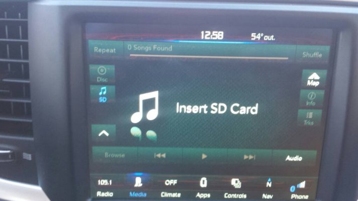

I installed the hub and conversion harness in my truck. Everything works accept the SD card will not play. I can play music off of a USB stick but it's kind of temperamental. Android auto and everything else works great. I was kind of hoping the SD card would work. I'm one of those rare guys that actually use it everyday. The SD card and USB run off the same line so SD card not being picked up by the radio doesn't make sense. My truck has all the proper codes and configurations and I've had the SD card for years so I know that's not the issue. It was getting pretty dark and raining so I came inside I got to take a look at it tomorrow see if I can figure out what's going on.

OK I worked on the radio again today and I definitely cannot get the SD card to function. I try ed reformating the card from Fat32 to NTFS and the radio is still not picking up on the SD card. The screen comes up but doesn't recognize the card when you insert it. I have had some people say that the SD card has worked for them so hopefully mine is just an exception. The USB works fine to play music so it's not the end if the world. Also Android Auto is pretty nice to play music through the phone. The new radios are extremely fast to boot up and change screens. You have album art on AM/FM stations which is cool plus both the UAS and UAQ both have HD Radio now. The Android Auto and Apple Carplay are a game changer. This radio I'm testing is a UAS non nav radio but I can run Google Maps or Waze maps through it or Apple maps for an I phone and it works perfectly. If I hadn't already ordered my UAQ radio I think I would be absolutely fine with a UAS.
