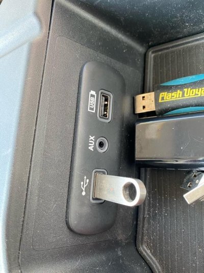

Just installed the uas radio , everything looks pretty good except not able to connect to Bluetooth yet or car play , I haven’t ordered a new media hub because mine I wanted to test first as it appears it’s the correct shape but the front looks slightly different . This media hub came from a jump seat addition from a 2018 .
So The radio sees my phone in the car play area but when I hit connect it errors out . Not sure if that’s because of this module or just some other issue .
