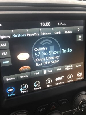

Got my 2019 UAS from a 1500 classic in. Disconnected battery, installed radio, reconnected battery. Radio works! Some bcm Settings are not present yet (heated seats won’t stay on?) but it’s been said that takes a while to populate everything into the radio. Truck will sit overnight and in the morning the settings should be normal or mostly normal. I did notice the clock show up before I shut the truck down. So that’s maybe a good sign as it wasn’t there at first? Maybe I didn’t notice it.
SXM button was not present yet either, which is normal.
I’ve done the single zone atc mod, and the heated vented seats mod. Hopefully everything will show up properly.
Wolfpup
Sep 19, 2018
89
39
Shirley, NY
Just checked because I’m impatient.
everything works as expected.
-Single zone ATC works, no anomaly with the fan control going past 7, so I’m thinking blend control works as well. I’ll know in the early morning if the cabin warms up normally.
-Heated vented seats work, but doesn’t display. (Expected without the module from infotainment)
-SXM works and displays in the 7” cluster fully. The cluster is from a 2016
-compass does not display yet. Maybe tomorrow? I don’t know.
-backup camera is crystal clear, even in the dark? I thought I’d have to replace the camera?
-text messages sound like they’re yelling at me. Volume defaults to 15 when it reads them to me. I turn it down but it goes back to 15 for next text message. I’ll figure it out, I think.
-screen is crystal clear, super responsive.
Can’t test carplay or android auto. I don’t have the hub yet, harness arrived today though, thanks Deereguy and M2 mods for all the harnesses. They all work great.

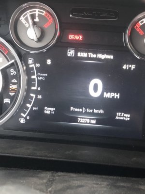

ManualCummins
May 3, 2016
222
102
Cummins 6.7
image.jpg image.jpg I’m surprise it displays in the cluster correctly most of them work but several XM stations don’t show up correctly
You can see how mine reads
I could never get the Compass to show up in there anyway but if you use alpha you can set it so it shows up in your evic anyway

I’ll check the station titles again to be sure. I thought that was normal, so I wasn’t expecting anything. The evic shows the compass heading.
Wolfpup
Sep 19, 2018
89
39
Shirley, NY
My evic looks like yours. It looked like that with the 2014 RA4 also. I thought it would have dashes when it didn’t display correctly, I thought I read that somewhere. Compass doesn’t show on the radio, it does on the evic. Single zone auto temp control works fine, no new hvac module needed... so far.
