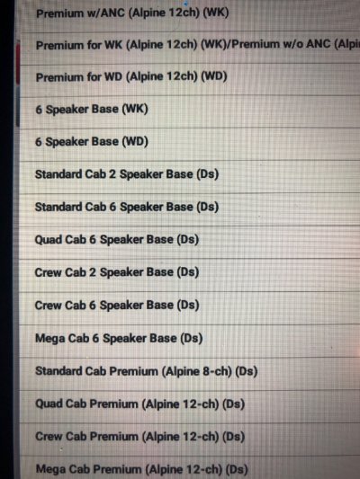

It’s almost to the bottom of the options for cabin equalization curve number.
Try the standard cab 6 speaker base DS. You can always try the quad and crew if that option doesn’t work. Just stay with the options that say DS
The standard cab premium alpine 8 ch is another good option to try.

I’m adding the 12 channel alpine amp to my standard cab which came with the Alpine 8 channel amp. When I pull down “ECU configuration 3- cabin equalization curve number”, I am not getting a drop-down menu like is showing above . There is merely a box to enter a number into. Is there something that needs to be done to activate the drop-down menu? Thank you
One of the updates took it out. It still works on the windows version. He’s supposed to be fixing it on the next update. In the meantime, you could use the first version APK in the previous versions list in post 1 of the AlfaOBD thread.

Thanks, great information. Thought I was doing something wrong

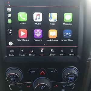

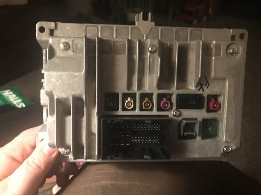

For the 2018 model year RAMS, the 8.4 Radios were changed from the previous VP3/VP4 Harman radios to the 4C/4C-Nav radios made by Panasonic. The biggest advantage of these new 4C Radios is the support for Apple CarPlay and Android Auto. The radios themselves fit the same mount as 2013-2017 RAMS and the radios require no special programming to work. They read the BCM of the truck just like the VP3s/VP4s. However there are some known issues and components that need to be changed to make it work 100%.
Thanks to MPGRIMM2, RICKS RAM, 00R/T, and STDECO for volunteering to test these radios in their trucks. As a result, we have had them working in a 2013, 2014, 2015, and 2016 trucks. We have tested seats, backup cameras, cargo cameras, android auto, apple car play, and most of the radio's standard functionality in these models.
There are two distinct versions of the radio. The 4C (Sales Code: UAS) and the 4C-Nav (Sales Code: UAQ). The only difference between the radios is that the UAS does not have built in navigation and the UAQ does. Both units support CarPlay and Android Auto. However, unlike the previous VP3 radios, Built in navigation cannot be purchased and added to the 4C radio.

RADIO: 68331631AH (UAQ) or 68331635AH (UAS)
MEDIA HUB: 68328704AC (RAM) or 5XG28DX9AC (Compass)
MEDIA HUB CONVERSION HARNESS
RADIO
It is important that you get a radio that has the correct mount as the mount is now forged as part of the radio housing. Even though a radio out of an 18 Charger/300/Durango/etc will technically function the same as the RAM radio, the mount will not fit the RAM. Can these radios be modified to fit in a RAM.. Maybe, but I wouldn't recommend it. I broke a screen trying to transplant a UAQ radio into an existing VP4 mount.
It is also important that you get a MY18 radio. All MY18 radio part numbers start with 683.... The RAM themes are only available on MY18 year radios and the firmware must be at least version 18. There is a round colored dot on the top of each radio that has a number in it that reflects the firmware version that the radio had on it when it shipped from the factory. Anything less than 18.7 may have functional problems. It is possible to upgrade radios with older versions of software (I have upgraded to 18.14 all the way from 15.5 on one radio) but I also had one fail the upgrade process. Be wary of "AA" revision radios as they are really a crapshoot of what you are actually going to get.
As of now the radio can be purchased brand new from FCA. The cost is around $1200 for the UAQ, and about $100 for the hub.

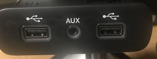

MEDIA HUB

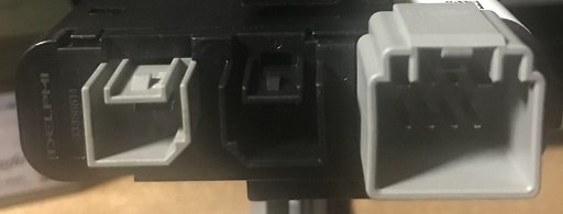

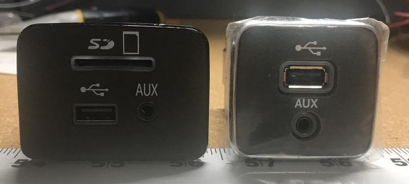

The media hubs in pre 2018 RAMs will not work with the 2018 Radios. Unfortunately RAM changed the form factor of the media hub in the 2018 RAM Trucks. The 2018 hubs are oblong in shape compared to the square 2013 - 2017 hubs. The closest compatible hub that will fit the existing opening is the compass hub. It is not an exact fit, but it generally fits. Changing the hub in a center console truck is easier than changing it in a jumpseat equipped truck.
2018 RAM HUB

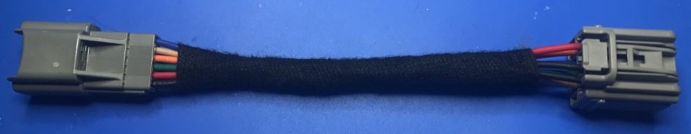

The connector on the rear of the media hub is also different, so a conversion harness will need to be built to adapt the current 6 pin connector to the 8 pin on the new hubs.

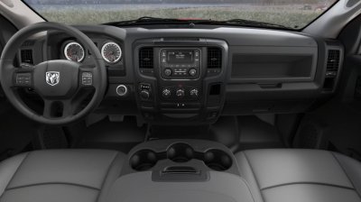

So I have a Gen 4 2019 Classic with the smallest Uconnect radio known to man, will the radio and console you listed work in my truck, I already have the media hub, just want a bigger radio. and what else would I need to add the nav part
