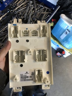

ManualCummins
May 3, 2016
222
102
Cummins 6.7
I’ve got a BCM out of a 2018 if somebody wants it

48PowerWagon
Nov 22, 2019
193
182
Bellingham, WA
I would like it, if will help in a whole slew of upgrades to my PW, UAQ, Laramie Seats and Door panels, folding mirrors, Autodim Highs, man the list is long, still I'll be busy a long ass time....
ManualCummins
May 3, 2016
222
102
Cummins 6.7
100 shipped and its yours
I did trim the corner a little bit so you can get it in and Out without removing the pedal assembly
The only thing you need to remove is the parking break which is only 3-13 mm bolts and you can slide it out PayPal [email protected]
ManualCummins
May 3, 2016
222
102
Cummins 6.7
Sold He bought it for me I’ll print off the label and will drop it off at the post office tomorrow

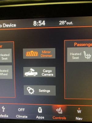

If you just want and additional input you'll need to activate
VehConfig 1 - CHMSL Camera
CBC Features - LED CHMSL Lamp Present
This will give you the Cargo Camera button.
@Mpgrimm2 sells a harness for $20 that you can then use to plug in any RCA camera you choose and have it accessible by pressing the cargo camera button.
Does that answer your question?
This is what I did, however I was looking to get the “Back Up Camera” soft key instead of the “Cargo Camera” soft key. I was able to to get the “Cargo Camera” soft key and it will work for what I need. However, I still yet to receive a “Back Up Camera” soft key for just the back up camera. In the picture it shows the cargo camera soft key, but no back up camera soft key. Any idea on what to do to enable that? I don’t need an additional camera input, was just trying to get the factory soft key.

Yes, however I have the VP4 Nav radio originally, and just upgraded to the 4C UAQ. I have seen the soft key for the back up camera a million times on other people’s vehicles with this same radio.

I am unsure if it was on the radio before I received it, but it isn’t on mine. I’m in the United States and that’s where the radio is from. I am being told it is from the “Trailer Hitch Camera” option not being enabled in Alfaobd, but when I go to the 2015 Body Module it does not show as an option.
