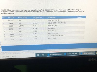

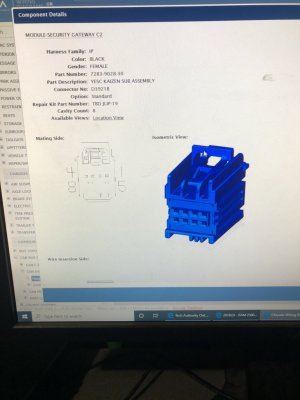

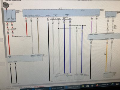

After hours of searching the only difference that I can find
Is the gateway module
The only thing that I can gather is that the gateway module somehow modify as the Signal
The gateway module sits between the BCM and the radio

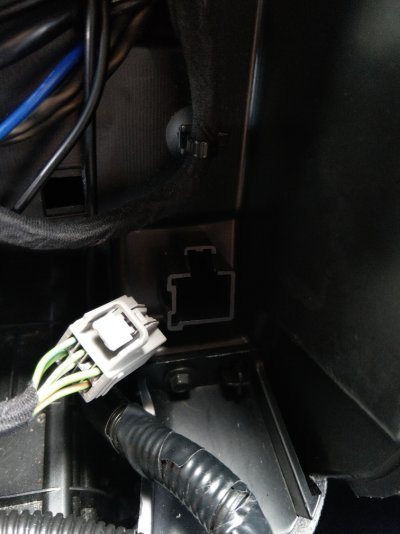

you wouldn’t happen to have the connector would you

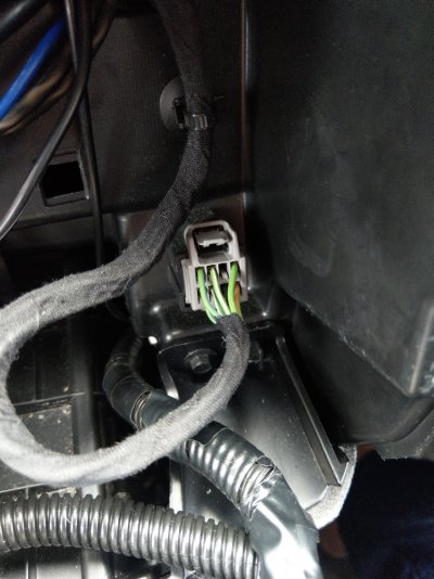

View attachment 194772 View attachment 194778
Is that this dead plug behind the radio/HVAC bezel in the lower right of the opening (see pictures)...if so, mines just plugged into a blank socket unless something has fallen out on the reverse side.f73d1faeb1906d791c2451e4cce0a91e.jpg8da6f19486d50a167f00c0d64823c468.jpg

I physically went and checked with the application tag every pin in the BCM there’s no difference
The only physical differences in the actual wiring diagrams is that the signal goes through the Gatway module
