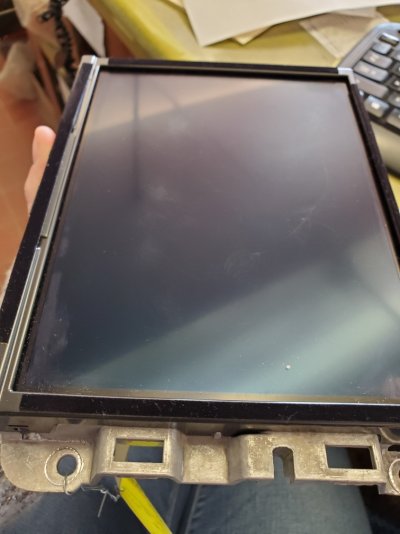

I also found a UAQ for $600 today (see picture) and they said the screen was scuffed. The same place had a UAS too but I didn't get a price (I assume less than $600).

My UAQ from LKQOnline was a few dollars less than @SitKneelBend paid for the UAS. It has a tiny mark on it and once I put a screen protector on I never really saw it. I didn't get the hub though but I have a 2018 and android so my original hub was usable. Patience and vin #'s to check the build sheet and some luck.

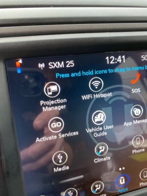

Honestly I'm not sure. It looks like it's still settling into my truck. It has dual climate on screen but I'm a single. In addition, there is no SXM button (that I see). It appears to have been out of a wrecked rental vehicle (lots of paired phones with names too diverse to be family).
Any tips for a newbie? I've done two power cycles.

Takes a while for the Sirius button to light up sometimes. I would defer to others with a UAS as to where to look for the sirius subscription screen , single zone change with alfaobd and compass heading, etc. If I remember correctly you can go into the apps page and move what you want to the home screen. I'm not by my truck right now and have a UAQ so I don't want to give bad information.

The UAx radios won't be done reading the BCM config/resetting until the sxm button shows up and the backup camera works.

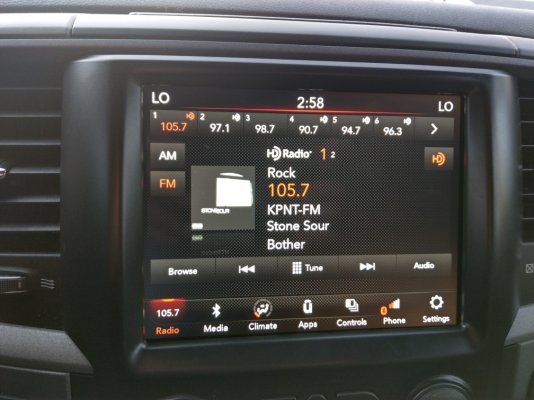

I finally completed my upgrade....
  • 2018 UAS updated to 22.6 by @Mpgrimm2.
  • 2018 USB media hub 68328704Ax
  • Temp sensor for ATC conversion 55111178Ax
  • HVAC module 68366553Ax
  • Single zone 8.4" bezel 1UJ96DX9Ax
  • 7 speed blower resistor from M2 Mods.
  • Wiring harness from M2 Mods (for 4>7 speed conversion and ATC temp sensor)
My truck is a 2018 Tradesman 2500 with the Power Wagon option. Basically a base model truck with the Power Wagon chassis. I really disliked the 5" radio and have been looking at the UAx upgrade for quite some time. I made the mistake of buying a Delphi radio from a 2019 1500 thinking that I was going to receive a UAS. I still have that one if anyone wants it ;).
@Mpgrimm2 was extremely helpful with getting the right parts and instructions to make this conversion. There were a couple of gotchas in my case... Be sure to read Mike's instructions carefully. I tend to glance over these things and missed one or two points.

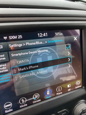

  2. In order to get Car Play to work, I needed to go into Settings > Phone/Bluetooth > Smartphone Device Mirroring, then select my phone, then select Enable Car Play. Last, select connect to phone. I also found it under Apps and Projection Manager.

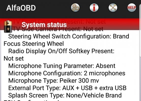

Oh, and one other thing.... Doesn't anyone know which setting in AlfaOBD allows me to turn on the backup camera button in the UAS? I have driven other vehicles with UAQ radios and have seen the backup camera button and been able to turn on the camera while driving.

For the RAM Dual hub xxxxx704AC...
Ecu Config 3:
-> External Port Type : Aux + USB+ extra USB
M² Mods.
Thanks! I got the harness today and plugged it in. It appears to work although I haven't made the Alfa change for the connection. Is it necessary? Is there some ill effect I'll experience if I don't change that setting?

Try to play USB music/connect Android Auto or CarPlay through both ports... Only one will work for data until the change I believe
