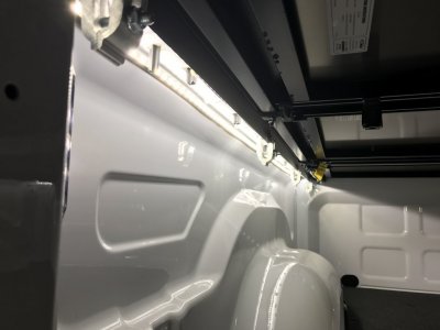

I was trying for that too but too many hangy down thingies (lol) to accomplish my ocd straight line complex
Luckily my lights are flexible...lol
I have ones that look similar and yes they are flexible....little too much lol
I actually ended up mounting them on the side of the bed rather than the bottom of the rail. They are still tucked way up there and invisible but it seemed to throw the light better into the middle of the box instead of down at the wheel well. Also it avoids all those "hanging down thingys" :D
that's my plan as well, just like in the vid

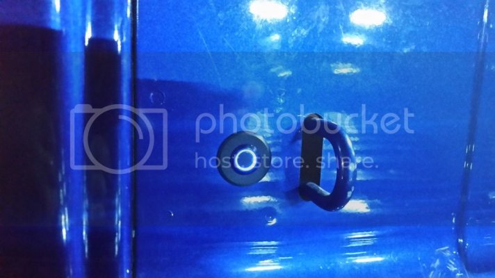

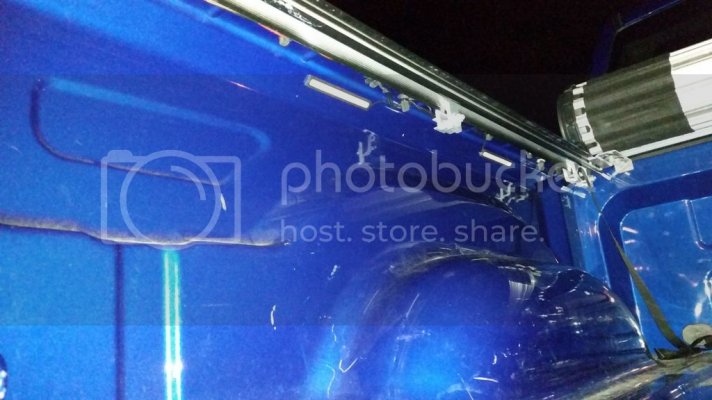

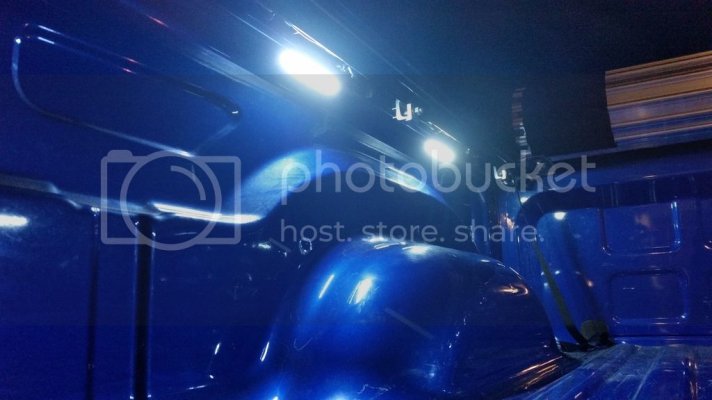

I used some LEDs from Oznium. I tapped into the cab light but I also installed a switch in the bed wall and isolated it with a relay. I put a diode in the cab light line to prevent power from back feeding to the cab light. This way I can power the lights from inside or out.

Nice work Pistol! I've debated doing the extra wiring for the remote switch that is included in the kit I used but haven't had the need just yet :D

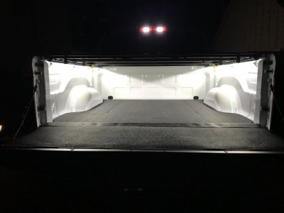

LED 921 Cargo bulbs I showed in another vid + the LED strip lighting used in this one = :waytogo:

Damn JB1, I'm including you in my OCD club. More like OCO since I don't feel its' a "dis"Order. Looks like you've been waxing and polishing the inside of your bed. I would eat dinner off of it if the mess wouldn't drive you nutz. Lookin good!
Lol ya the white helps to make it seem very bright

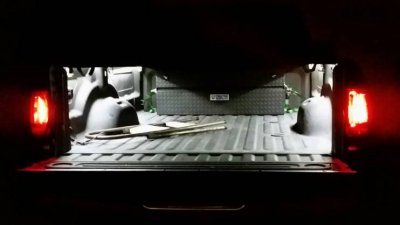

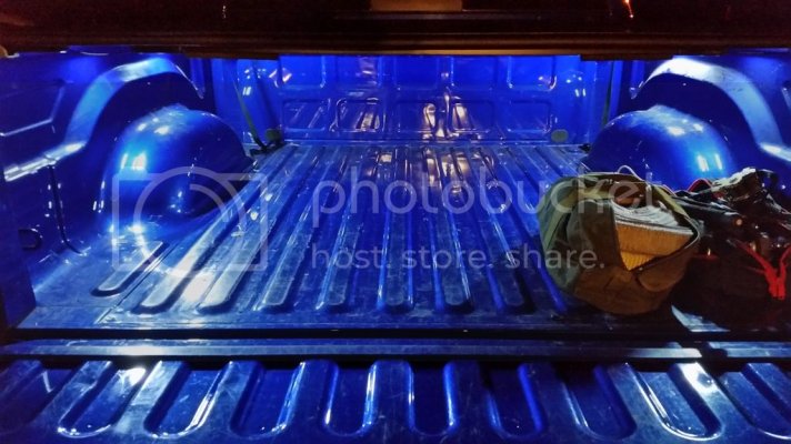

I put LED tape lights under the bed lip of my buddies 2500 w/8' bed. Tapped power off the +12V from the 7 pin trailer plug. I mounted a safety switch on the left side just under the bedrail also. He said it works great for when he's hooking up his fifth wheel trailer.IMG_20161016_200314-01.jpeg
