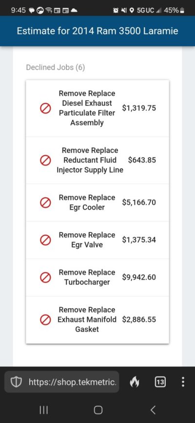

I brought my 2014 6.7 cummins into the shop for it not running. The shop says the entire exhaust system, all the way to the exhaust manifold is clogged. What do I do?! They are saying it'll cost 21g to fix! Could I just delete it?

As mentiond above 21g is HILARIOUS. Pull that crap apart yourself or go to another shop PA has a lot of terrible mechanics/shops depends on where aswell but i wish you luck.
Just curious, clogged from what? I just watched Beverly Hills Cop, did you check for bananas? :)

Shop is lying.
Literally not possible for the whole exhaust system to clog, and even if it was possible, 90% of the system is open pipes you could clean out with a stick and a brush. It's most likely that the Diesel Particulate Filter is clogged, that will completely plug the exhaust, stopping the engine from running. IDK if a clogged DPF can be cleaned out (I'm sure someone here can tell you if/how), but a new one (Mopar 68417517AB) looks like about $1,800 from Mopar, and it shouldn't take more than two hours for a muffler shop to install. There may be other sensors/misc. parts and programming.
For $21,000 that exhaust better come with a new engine.

Maybe they added in an extra 0. Dunno if you can get away with a delete in PA, so you may be better off replacing the DPF. You can do it in the driveway in about an hour. Both cost about the same amount, but the DPF swap is much easier mechanically.

I'd ask to see the labor rate they are using. $1K is about right if the hourly rate is $750! Towing to ANY shop would be cheaper! OR, run it "Commando"!
