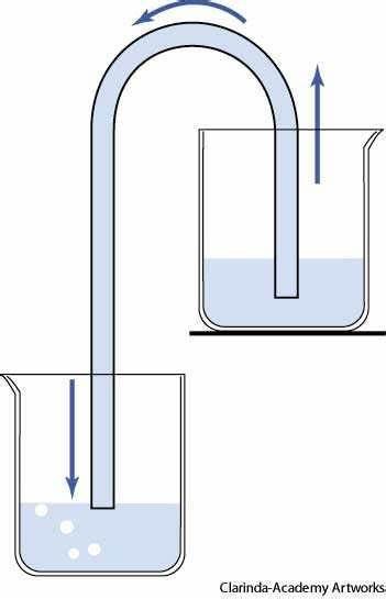

principals of siphon, if you use a clear tube you can suck until you see it breaks the U, once the fluid in the hose is lower then the hose going into the fluid, you have a siphon, once a siphon starts it will empty the tank.

The other way it to use a hose, simply put your hose into over flow, turn it on until water comes out then turn off, unhook hose from water spigot, set hose lower then overflow tank, siphon will empty tank.
