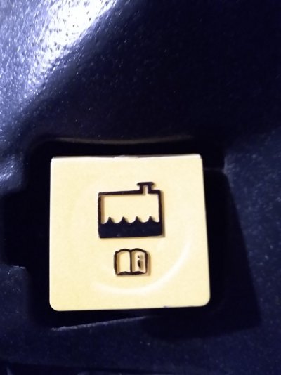

Takotzen
Oct 28, 2020
15
16
Tennessee
I opened the hood, saw the yellow cap on the left, opened it and started to pour windshield washer fluid in it. and that is when i realized the other BRIGHT YELLOW cap that has a windshield washer symbol on it. I quickly pulled back the jug, and said the F word out loud. o_O
I probably poured about 1-2 cups in there. Should I go get it flushed right away? From what I read on Google, most says it'll be fine, but some can turn the coolant into gel.
I did the exact same thing back in March. Although most said I would be fine , I had the dealer flush it for me. Just some peace of mind.
