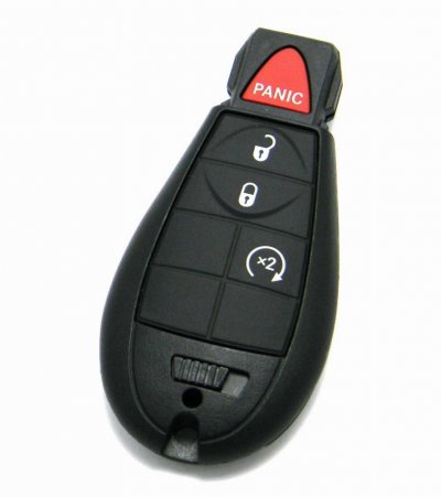

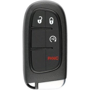

The keys that come in the kit are designed to replace your current keys. They look exactly the same as what you have just with the remote start button.
For the "baseline" fobs
For the "highline" fobs
I believe it was @Jimmy07 discovered that the keys that came with your truck already have provisions and are programmed to work with the factory remote start you just need the cover with the contact for the remote start. ( I believe that it's only for 2017 and 2018 truck's, maybe 2019's)
I went with these
QualityKeylessPlus TWO... https://www.amazon.com/dp/B017MVAO6Y?ref=ppx_pop_mob_ap_share
And work perfectly. I now have 4 fobs for my truck that will operate the factory remote start.
There is also a cheaper way of getting a factory remote start. Buying the new skins (if I can find either the thread or the pin part numbers) take a short piece of wire and the correct pin, insert it into the same slot (11 I think it was) and ground that wire ( that's all the hood latch in the kit does) program everything (except for the keys) the same as the instructions in my link says and you'll have a working factory remote start.

I like the look of those keyfobs better than the one I just bought for my 1500. Is that weird? :)

I'm not exactly sure what year the "highline" fob I posted is from I just Googled ram key Fob to post the different styles. The "highline" is for push button start equipped trucks
chrisbh17
Oct 12, 2017
6,720
7,527
The one I have doesnt have the nice silver inserts between the rows of buttons.
Stupid, I know, but it does look better with them :)
