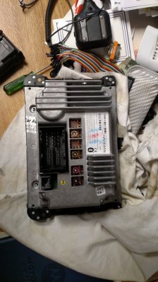

Post a picture of the back of the radio you purchased.
I have the FW 17.11.7 currently installed in the original radio so I am past 16. Still no HD radio.
As for the new radio, I am going to return it. Going to try to find a 2014 VP4 RA4 NA radio.
Thanks,
Craig

Returning the radio. Had to pay a restocking fee even though they misrepresented the radio.
If it does not have the Ibiquity license printed on the label on back, it is not capable of receiving HD radio. The NA radios have this, the CA radios do not.
