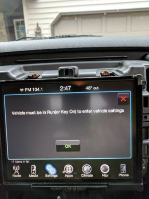

I am in the process of putting a 8.4 VP4 NA part# 68258671AG software version 15.41.4 in my 2015 1500. The truck came equipped with the smaller touch screen model.
However I have run into a snag. I don't get any volume and on the settings page I cannot access any of options I get a message saying key must be in run position. I am at a loss I don't know where to go from here.
Please can someone help me.
Can you send a picture?

What would you like a picture of?
"on the settings page I cannot access any of options I get a message saying key must be in run position."

That's strange...is the radio from a RAM truck? If you can I would try to perform s factory reset on the radio. Hold down the hot and cold HVAC buttons until a menu pops up. Hopefully you have the 8.4 HVAC control bezel already right? If so, there will be a factory reset option in that menu.

Yes it is from a Ram. I got it used. Came with the bezel wiring and additional module . I did the factory reset . Only thing that changed is now the background shows the u connect logo and not the silver brushed background. The only way that it will make sound is if connected to my phones Bluetooth and I make a call . It will play through the truck speakers .

Yes it is from a Ram. I got it used. Came with the bezel wiring and additional module . I did the factory reset . Only thing that changed is now the background shows the u connect logo and not the silver brushed background. The only way that it will make sound is if connected to my phone and I make a call .it will play through the truck speakers .
Do several power cycles. Key out, door open then close, wait for dash lights to go out then turn the truck back on. Let radio power up completely and repeat (x3)...
Take a look at post 5 about possible issues with 2016 Ra4 Radios in earlier trucks.
https://www.ramforum.com/index.php?posts/1125807
This sounds like your issue. Read the 2 linked posts there and let us know if you think it's the same?
I tried 3 2016 radios in my 13 ram and couldn't get any to work. Tried updating the FW in my truck and partially brick it. If it's not recognizing truck is in run position, don't try the update. Worked fine in DeereGuy's 16 ram 2500.

Yes ( No Sound/No Volume up & dwn control. "Settings"menu locked out/doesn't recognize key in "run") is exactly what I have going on . I bought the kit form a guy on Facebook 4th gen page he had it in a 2015 as well. The harness is all white wires.

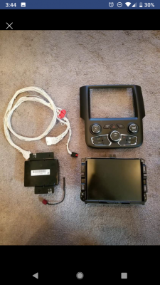

Just curious... Got a picture of the harness before you installed it?
Sounds like a 16 radio is a no go in your particular truck. Can you return it?

I bought it from a private party.
Not just because I make them but, Ugh....
Are those 3m Scotch Lock splices on there? That looks rough & like a problem waiting to happen/fail. Can't imagine what the crimps inside the connector look like if the splices for the bezel aren't even soldered. That's just bad.

First thing I did was cut out the sections of damaged wire from the Scotch locks. And replace with heat shrink barrels . I am an electrician by trade so I know those things are bad news. (Since all the wires are white I did this one wire at a time so there was no confusion .)
