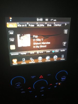

As stated settings and then themes. If you have a 13 or 14 radio it will not have the options of different themes unless it has the newer firmware installed.

If you have not updated the firmware in your 2015 radio you are correct it currently has 5 themes if you update your firmware to the new 17 series you would have 7 themes you would gain a new blue screen which I love plus the red rebel screen

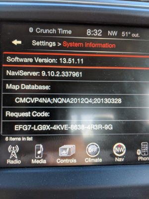

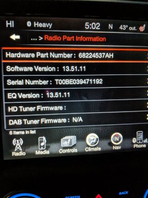

Thank god I found this thread! I almost gave up hope. Maybe Mpgrimm2 has an answer for me. I just purchased a used 2014 Ram 1500 limited pickup last week. Being in the IT field the first thing I checked was the version of software I had. The truck currently has version 13.51.11 I see the newest version out is 17. I went to the u connect website and put my vin # in and it's saying that my software is up to date. I spoke to a jeepcares person on a different fourm and this is what they told me.
"Software updates are not universal, and therefore not all 2014s will have the same software level. It can vary depending on your specific vehicle. As previously stated, your Ram is currently up to date".
Here's the info on the truck
43,000 miles on the truck
2014 with a build date of 3/14
8.4 screen with navigation
current firmware version 13.51.11
Truck was built in the US and sold in Canada. Came back into the US and resold here. I attached pictures of the radio part # and software# I looked at page 1 of this thread and it looks like the part number of the radio doesn't match any listed. Am I out of luck? Do you have a version that will work with my radio? Please help!!
VIN # 1C6RR7PT2ES308103
View attachment 146991 View attachment 146992
Mpgrimm2 is your Man !!
