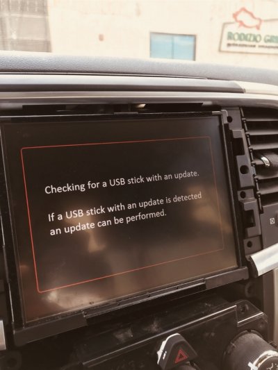

hello sorry to you of all successes ah this attempt to update my uconnect 8.4 ra4 nav but I get this checking for usb stick with an update if a usb stick with an update is detected an update can be performed there was an issue while starting the head unit. if this error persists after an ignition cycle please see your dealer.d5891bc0bd96bb0e32c83d85529a0cd0.jpg

Now sure what year and model Ra4 you have (ie, -NA, -CA, -MX), or the software version you're trying to load but it should be formatted as fat32 and should have is "swdl.iso" (and maybe one more depending on the version/year).

It's a ra4 na the year I do not know and the one who sold it to me gave me another one because it marked a ra3 no navi I try to update but I only get those legends that says usb do not detect

I've got an entire list of PNs in the first 6 posts that will help you identify what year radio your have. Does it/did it work before trying to update it? (Ie the radio and USB port on the console/seat with a USB drive and music on it (not the one on the dash)?
