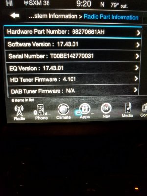

I just updated a VP4 NA radio. The VIN said it was 2016 RAM 3500. The part number on the back was 68270661AG. I downloaded the UCONNECT_8.4AN_RA4_17.43.01_MY16_NAFTA.zip firmware and the radio said wrong bootloader, model year does not match and the update failed. I downloaded UCONNECT_8.4AN_RA4_17.43.01_MY15_NAFTA.zip and it worked fine.
Interestingly enough when Sirius activated the radio it seems their records show the radio number going to a 2017 RAM 3500. I tried UCONNECT_8.4AN_RA4_17.43.01_MY17_NAFTA.zip but the radio said it couldn't read the drive. Tried another drive and same result. I noticed this update did not have the swdl.iso file while the 2015 & 2016 files contain the iso. I have all 3 firmware files if want them for this thread.

When you go into the dealer menu... What PN does it report?
Wondering if your real is preferred together from various parts, it's rare but does happen from time to time.

Here is the radio info. After the upgrade the attached text file was written to the thumbdrive. I purchased the unlock code from IVGSoft and the P/N was definitely 68270661AG on the back of the radio. The build sheet from RAM says the VIN is model year 2016. At the bottom are these lines;
old part number with suffix =>
68270661AG
new ecu part number is =>
68270661AH
ECU part number Update successful
Software Update successfully completed
Version = 17.09.01

Perhaps the donor truck was an early 16 that was actually built in 15 and they had 15 radios in stock at the assembly plant. My RAM is MY16 but the VIN sticker says it was manufactured 9/15. The RAM build sheet says my truck is an MY16.
Oh well the radio is working fine. Not sure I'll keep it since I am still going back and forth on the VP4-NA versus the UAQ. I am perturbed they took voice text out of the UAQ because Android Auto and its voice texting sucks.
