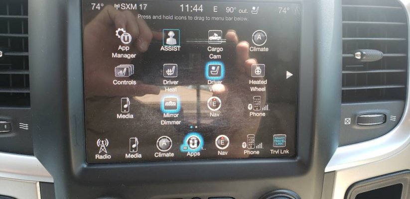

So I added a cargo camera to my 2015 ram with 17.43.01 and installed the wiring harness for it. And of course it did not work after enabling it with Alfaobd. The LED light works good with no errors. What are my options to making the camera work? Buying a used radio off 2016-2018 Ram? If I do that, will I need a dealer to program it or is it plug and play? Any input would be greatly appreciated.

Is your backup camera working? Rule of thumb the 13 to 15 radios show the backup camera in the rearview mirror when the truck is equipped with a Cargo Cam. There was a firmware update 17.11.07 which had a glitch that allowed the 13 to 15 radios to display both the backup camera and cargo cam on the screen. This was corrected with the 17.43.01 update. They changed the format for the 16 and 17 trucks for both images to display on the radio screen. The 16 and 17 radios will show both the cargo cam and the backup cam on the screen no matter what year truck they are installed in. Are you sure the code is in the truck? Do you have the cargo cam in your app screen like this?f40264d4b69e57e0c9e4c595d1458029.jpg
