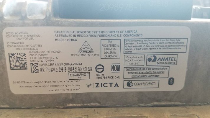

Use that vin to verify the build sheet/radio info using the link below. There's some ambiguity on the actual sales codes vs model numbers on the 2018+ Panasonic radios. That file name looks like a UAx radio file.
(Copy this)
http://www.ramtrucks.com/webselfservice/BuildSheetServlet?vin=
copy this link and then paste into a web browser address bar, add your vin# to the end, after the "=" hit Enter.
It's possible that's a Jeep UAQ radio as you thought. The sides of the radios actually have vp4r-A on the sticker. If the SW is compatible it may flash. Otherwise it normally would not allow it ... But you are flashing it in a ram truck with a different USB hub/driver and may run into an issue... Nothing guaranteed.

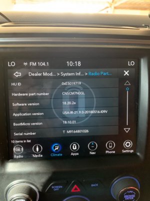

Hey no worries @chrisbh17 , I just appreciate the input=)
@Mpgrimm2
used that link, under optional equipment it just shows 8.4 Radio and Premium Audio Group,
My radio shows this. Capture.JPG so thats a positive=)
I am using the Jeep compass HUB if that makes a difference or not. If 22.6 is the latest package Im surprised that didnt show as the software available, but thats just the I.T. guy in me thinking haha. Is 22.6 available for download? Thank you again for all the great info!

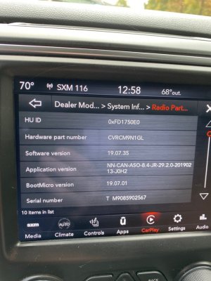

Hello can you guys help me check if I need an update? I have just installed a UAQ from a Chrysler on my Ram. I can't get radio to output audio but over Bluetooth no issues
Rudey
Sep 23, 2019
20
10
New Jersey
V6
Follow up from discussion in How to Install a 2018 4c Thread
Your application version appears to be v29.2.0 ? (Vs 22.6)
Is your truck a 4th gen or 5th gen?
Are you running a USA UAS radio Canadian?
Does your radio PN end in xxxxx635Ax ?
(Is it from a ram or Jeep vehicle?)
PS: here a link ... Please see the full post...
8.4 fw/Info thread post 8 for the 18 UAx radios.
(Don't want to clutter up this thread).
M² Mods.
  • Below is a pic of the system info page showing the software and application versions.
  • My Truck is a USA - 2016 Ram 1500 so 4th gen.
  • I purchased the radio off of ebay, the seller was located in the USA, but looking at the App version, I am guessing its actually Canadian. Looking up the VIN the seller gave me shows the donor truck was a 2018 Dodge RAM 1500 SLT manufactured in WARREN, MICHIGAN, UNITED STATES (USA), not sure that means anything though.
  • To get the part number I will have to remove the unit, so I will post an update.
  • UPDATE: Took the unit out Canadian Part No. 68461748AA
  • Radio was sold as for a Ram, however when it first booted it flashed the jeep logo and then after reboot it had the ram logo. I will confirm once I get the part number.
If it is canadian, am I out of luck or should I be looking the canadian firmware?
