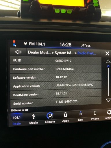

Well, I’m shocked, but I drove my truck yesterday after it sitting for a week and my ATC is back. I don’t know why sleeping it overnight wasn’t enough, but I’m not going to complain. Other than the nav, I took a radio from a 17 300 running v14.9.0 and brought it up to 22.6.0 RAM firmware successfully.
Now I need to decide if I should try going to the previous version that includes map files to try to get my nav back. I’m a bit concerned about the ramifications of going backwards, though, so I may wait and hope the next update is a full one with maps.

Have you figured out a way to go backwards? or does the UAx actually let you do it (unlike the RAx)?
So I updated my 2017 300 yesterday to 22.6 and lost NAV like you I was able to install the correct max version for the 300 22.5 and got NAV back. I was surprised it was able to downgrade a version but it worked fine took about an hour though.
Where’d you find the 22.5 image? I’d be willing to give it a go and jump back to that and see if it still has RAM themes (I suspect it will). If not, I can then try to jump up to 22.6 again.
