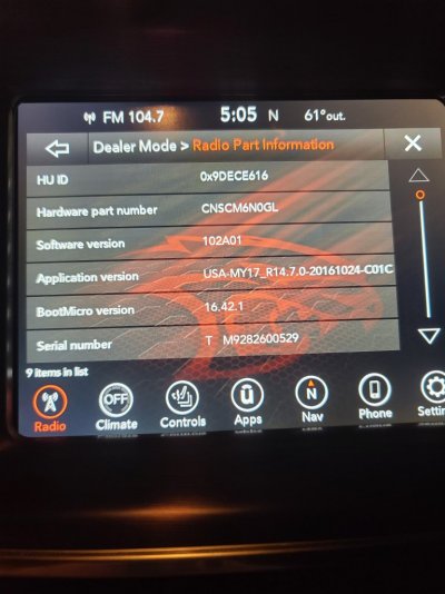

This is where I am at with my Uconnect and I am wondering were to go from here what software do I need to go to next? I am wanting to update since my gps has been out forever and can't get any of the dealerahips in my area to figure it out....16349903942766268107482869740428.jpg

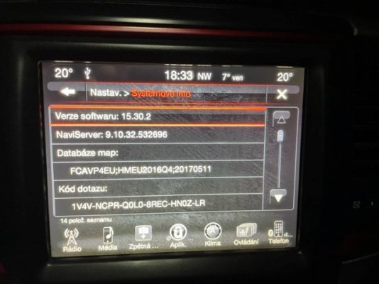

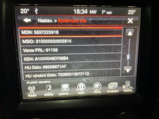

Hi,
I have Dodge RAM 1500 REBEL 2016, PN: 68258671AF, FW: 15.30.2
When I tried to upgrade to v17.43.01, the upgrade ended with an error: This is not a compatible version. This version is NA and you need the EU version.
The same issue is with v.17.11.07.
Have you EU version FW for upgrade???
Bellow is screenshot from infotainment:
Thank you for help.

Hi,
View attachment 476176View attachment 476177
Thank you for help.
I don't. But check towards the bottom of the first post for an alternate link that has some of the EU stuff.
