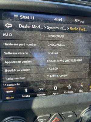

So I guess I’m a little confused on whether I should up date or not? And what to update to.. also if my software version is current.
From what I’m understanding the current software for 2018 Ram 2500 Laramie with navigation (my truck) is 22.61?
If that’s the case I’m pretty behind it seems like, but when I enter my VIN in Uconnect it says no update available..

you go by application number on the panasonic radios.yours shows 19.9 the best application for these radios many say.if you are having no problems LEAVE IT.AND 22.61 is a over the air update i don't think dealers even have it yet.new radios are shipping with 34.2 so it is kinda up in the air what really is the latest application for a ram 22.6 or 22.61 or 34.2 .like i mentioned if having no problems i think you will be much happier keeping the 19.9.i wish i could reinstall 19.9.

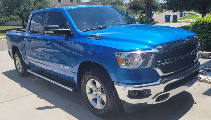

Bought a 2021 big horn and to my surprise it did not come with sos or assist buttons and is not compatible with uconnect app is it possible swap radio 8.4 for a 8.4 thats have uconnect features including the assist and sos button in the rear vie mirror?

I assume you have a new body style dt correct? If so check in the 5th gen forum.two totally different 8.4 radios in a 5th gen. One is one piece the other a unit and a screen.almost impossible to get chrysler to sign you up uconnect stuff if your truck didn't come with it on a 4th gen.my 20 classic with the uas 8.4 has the help and 911 buttons physically on the rear view mirror.

My 19 classic i traded for this one had the sos and assist on the rear view mirror 04075443b60ce5c3d5a5a062cdc11a70.jpg
