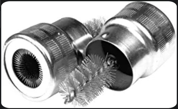

I would suggest you splurge and spend about $20 at HarbourFreight, buy a toaster-style battery load tester and another $3 for a battery post/clamp cleaner.

RamDiver, totally with you on this. I own both the post/cable cleaner and toaster and used both in my diagnosis.
