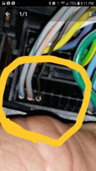

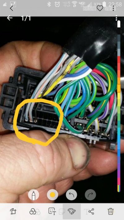

It should look like mine , like this ... Unless the factory installed wires are different .
Your truck cam from the factory with the backup cam in the mirror with the RA1 right ?

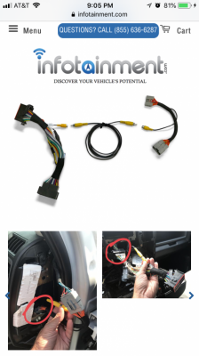

Mine are an rca cable splice in. But yes, I have wires in those spots with accretion to the shield, which I don’t have.

I also did continuity check on the rca cable and the pin block on the passengers side vent. The wire from the (green brown stripe) rings to the upper fat flat pin in the multipin connector at the radio. So signal in get there on one line I think. The rca cable rings true on both ends and goes to the 2 green wires with stripes at the pass vent
See I only have two wires were as you have 3 going to that block.

It may be a wiring issue (I don’t like that I only have two wires were I should have 3) or a configuration problem. I have a different dealer going to be checking it out on Wednesday. Hopefully it will be something my extended warranty will cover. If it turns out to be the infotainment harness. I am really going to be upset. My instinct was to get mpgrimm2 jumper, but I liked the pnp option with infotainment harness.

Not sure why your missing the shield wire in socket 33 ??
Maybe when the Bluetooth kit was installed the pin in either socket 31 or 32 was unseated ?
Not sure if this would keep you from getting the Blue screen while in reverse , but it definitely would keep the video from showing ....
Have you checked if the shield wire is taped back in the harness behind your C1 connector ?

The infotainment guy Chris said I don’t need that shield wire. Mpgrimm2 has 3 wire jumper too. The reason i have only 2 wires is the RCA cable. Which both wires are connected all the way through as I proved to myself with continuity check. I can only go by what these experts are telling me. I am electrician by trade, so I can do some things. But I am lost on software, bcm issues, CAN, and so forth. What is the module on the passengers floor by the firewall? Got a lot of wires leading to that. Going to investigate further later.
So your infotainment harness has all three wires to include the shield wire , but the truck side harness is missing the shield wire ?
#1 make sure the shield isn't taped back in the trucks harness .
#2 make sure on the trucks side sockets 31 & 32 are fully seated and the proper color wires are in the correct sockets .
#3 make sure the infotainment harness sockets 31,32 &33 are properly seated and jive with the trucks harness
#4 visually inspect with a magnifying glass 31,32&33 sockets for any damage on both the trucks harness and the infotainment one as well .
I can't think of any reason your factory harness would be missing the shielded wire ? I also don't think the absence of the shield would cause the backup cam to be inop .

Okay so the rca cable spliced in the info harness takes the place of those grey wires (your pictures) at the radio connect block, correct? And I have video signal at the pass vent connector block (I proved it). So the radio is just not recognizing the signal for some reason.... migraine... omg

This would have been so much simpler with mpgrimm2 jumper to the original oem connect block at back of radio. This harness is so hard to trace. I can’t tell if half the pins are seated correctly. What a pain.
