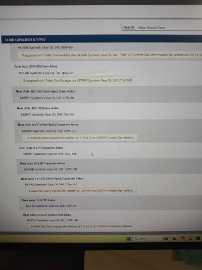

This is what I am seeing for model numbers?

Dredgers link leads to information that indicates 3.6 V6, 3.21 rear axle ration, limited slip rear axle.
I understand that but there were multiple models in 3.21 rear axle ration, I just want to make sure that 75w-140 is what I need. What confuses me more is if you jack up the rear and put it in neutral one tire spins forward the other backward and when driving burnout gravel snow only one tire seems to actually spin I though that was Standard not posi/limted slip. I just don't want to put the wrong stuff in it is all.

Anti-spin means limited slip, AFAIK.
I have a chevy with a Posi (limited slip) rear end, Both tires spin at the same time. This truck does not do that, I am a bit confused about that. Can anyone chime in on how a Anti-Spin Ram should act?

Now I am overthinking it lol, Can the build decoder that was posted above by a member be wrong about anti-slip(limited slip). Sorry for all the questions.
