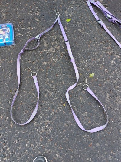

I just grabbed a couple of pictures of the webbing I use, rack pics will have to wait till tomorrow.
The Mosquitoes are ravenous outside tonight.
These are the webbing straps from Dollarama that I throw over top of my canoe to lash it to the racks.
Many people only secure the bow & stern, I like the added security of having the boat anchored to the rack.
My Dagger polyethylene kayaks are simple whitewater rodeo boats but if I put them on the racks, they'd be secured to the racks too. They're more money than I want to spend now.
Make sure to twist the webbing between the rack and boats, anywhere you see a straight piece otherwise, it will oscillate in the wind and the noise will drive you nuts. LOL
This is one of the V-straps that I use on the bow & stern, I'm sure you can locate something similar at a local paddling store.
Again, avoid having a long run of straight strap without a twist or 2 because it will vibrate, loosen, and make noise.
