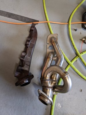

I decided to get ahead of the dreaded broken manifold bolts and just go ahead and replace the factory manifolds even though I'm just over 20k miles. I did tons of research on which brand to buy and ended up spending a bit more to get Kooks shorties. Yeah I know long tubes make more power, but I didnt want to go through the hassle of tuning and Colorado has strict emission testing so those weren't an option. I couldnt really find anyone who had installed the Kooks shorties before (https://kooksheaders.com/shorty-headers2238) but they were the only company I could find using 304 stainless instead of 403 or something cheaper. Unfortunately the only pic I took was the comparison shot below. These are some big shorties and I had a heck of a time getting around everything to get them onto the engine. The drivers side was standard installation (disconnect steering rack, bend dipstick around). The passenger side I actually had to unbolt the engine mount and raise the engine to clear the mount. I would say install took about 8 hours total over two evenings, and I could shave a couple hours off knowing what I am doing now. Kooks supplied Cometic gaskets which are the three layer metal type. I had a pretty good leak on the passenger side so bought some fel-pros which took care of the leak.
As far as sound/performance gain, if I gained any sound it was minimal. I'm still on stock exhaust though. Performance I can definitely feel some torque gains driving around town. Probably not a huge peak gain but definitely usable power.

Still really liking the headers. I have torqued them once or twice more since I swapped to the FelPro gaskets and I think the leak is gone, but they are quite a bit noisier than the OEM manifolds. I haven't looked up any videos or heard one in person, but it sounds like you simply hear more noise through the headers since they are thinner than the cast iron. The noise would be my only complaint. I think if I had aftermarket mufflers installed I wouldn't hear them at all, but I'm constantly second guessing if I'm heading header noise or a leak.
As for having the dealer fix it, I would say it depends if you have any broken bolts. If so, let the dealer do the bolt work and swap headers in later. It wasnt the most difficult thing I've ever installed, but it definitely was no cake walk. I would plan on a full weekend and another afternoon to retorque down the road.

MPG seems to be about the same. Seat of the pants feels like 5 hp/tq at most. Enough to make a difference but not appreciable. You can feel a bit more torque with normal driving. It seems a little less quick to downshift when going up a hill for example. I think with a full exhaust it would really open up and you would see more difference from the headers.
