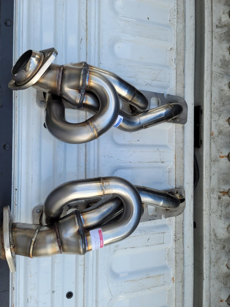

The main reason I installed shorty headers is to stem the broken exhaust manifold bolt issue. In that regard, these are definitely worth the upgrade. I did just tow my 9k pound trailer a hundred and fifty miles. The route included some freeway and some hilly portions. The truck did seem to have a little easier time making it up the hills. There was a definite difference in sound when loaded in the 3 to 4 thousand RPM range. When shifting down to help with compression braking there was also a different sound. Personally, I like the new sounds. I may be old(er), but I still like the muscle car (truck) sound.
Another picture...

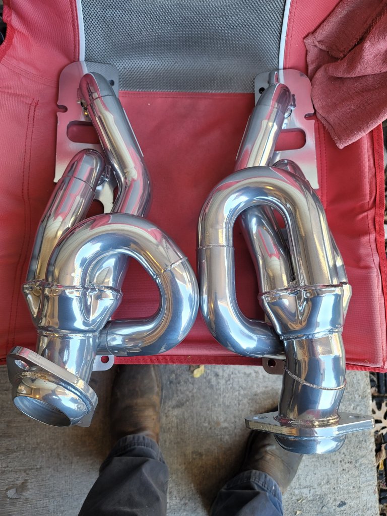

I decided to get ahead of the dreaded broken manifold bolts and just go ahead and replace the factory manifolds even though I'm just over 20k miles. I did tons of research on which brand to buy and ended up spending a bit more to get Kooks shorties. Yeah I know long tubes make more power, but I didnt want to go through the hassle of tuning and Colorado has strict emission testing so those weren't an option. I couldnt really find anyone who had installed the Kooks shorties before (https://kooksheaders.com/shorty-headers2238) but they were the only company I could find using 304 stainless instead of 403 or something cheaper. Unfortunately the only pic I took was the comparison shot below. These are some big shorties and I had a heck of a time getting around everything to get them onto the engine. The drivers side was standard installation (disconnect steering rack, bend dipstick around). The passenger side I actually had to unbolt the engine mount and raise the engine to clear the mount. I would say install took about 8 hours total over two evenings, and I could shave a couple hours off knowing what I am doing now. Kooks supplied Cometic gaskets which are the three layer metal type. I had a pretty good leak on the passenger side so bought some fel-pros which took care of the leak.
As far as sound/performance gain, if I gained any sound it was minimal. I'm still on stock exhaust though. Performance I can definitely feel some torque gains driving around town. Probably not a huge peak gain but definitely usable power.
