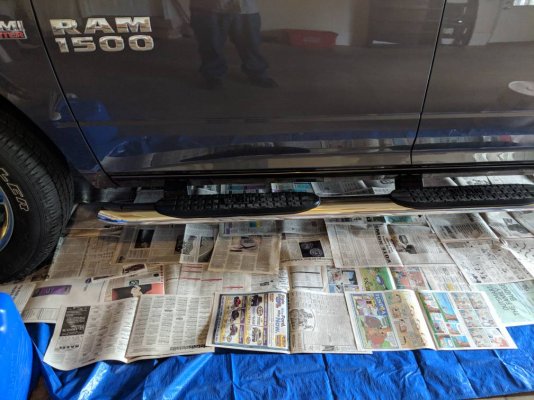

I just had my 2018 Krown-ed two days ago. This is my solution for a week to take care of any drips. I have an oil change coming up that I'm sure will be a bit messy.bf0809535070699e3d49bbcfe7f50ba3.jpg
