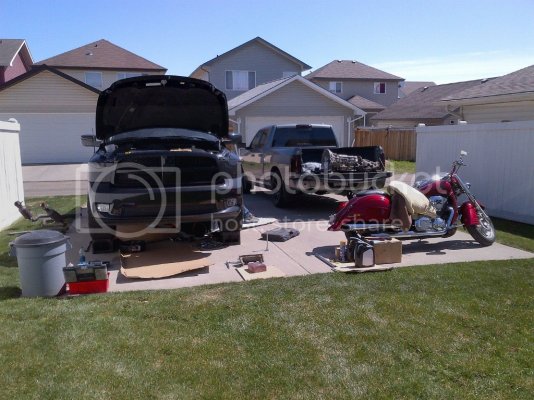

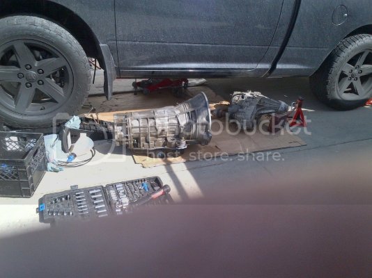

I never did send mine back, FedEx had way too many hoops to jump through,
so I found someone just blocks away from the FedEx depot (thanks to MGRAM's i-phone and Kijiji)
My L&M has been completely rebuilt by a local builder who does a similar build,
MGRAM has had his L&M redone there as well just last weekend (under warranty through MGH at L&M)
after it failed at the track and left him stranded after just a few passes.
Rob at Iconic Driveline Solutions
Brand New shop is based in Acheson, 418 Ellis Drive.
780-996-2306
Tell him Mike and Brad sent you.
He charged me $2300 for a total rebuild,
several 68RFE (Diesel trans upgrades) and a shift kit
cut, cleaned and re-welded my ATS torque converter,
repainted case and TC, all new fittings, sensors and seals, frictions and bearings
and he even came over to my house and quick-learn flashed it with his scanner/programmer after I installed.
3 year / 100k warranty
He can do installs too, new shop with a brand new hoist just setup on Monday
if you don't like DIY driveway install like MGRAM and I have done (6 times....so far lol)

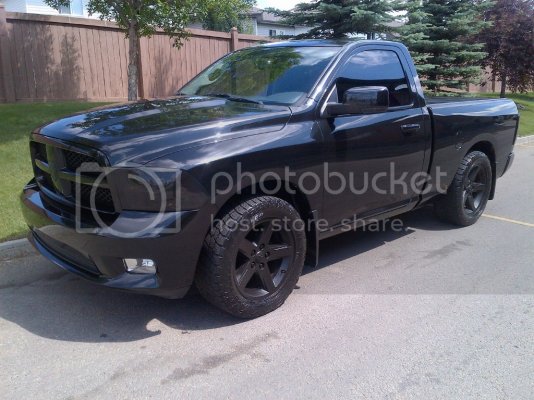

Its killing me how great those tires look on your truck. Aggressive, but not too much. What the heck are they? They look very similar to the size I run. Do yours rub at a full turn? Just barely?
BlackRamHemi
Aug 14, 2013
1,266
558
Edmonton Alberta Canada
2010

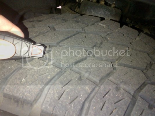

They are 305/50R20 Nitto Terra Grapplers, 12.2" wide x 32.2" tall,
about as wide as you can mount on a stock sport wheel without rubbing on a 4x4. (My 4x4 is dropped, Ground Force 2/3)
But although they look great, only lasted about 25k miles, pretty bad for a tire that cost more than $400 ea in Canada.
pic next to one of my drag radials when they were still fairly new...
pic I shot of my Terra Crappler last summer at just 36k kms (just over 22k miles)

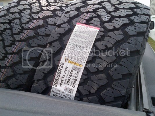

Knowing these will never see another Winter, (parked it last Winter)
I went tire shopping a couple weeks ago and found a good replacement for just $260 ea.
General Grabber AT2's , snow peak rated, winter stud ready,
Same size but treadwear warranty rated for 96k kms (60k miles) 16/32's tread depth, weigh in at 50lbs ea.
I saved a crap load of $$$ and even had enough left over for a new set of 14' Sport wheels someone removed right at the dealership from new.
While I'm waiting for a new set of TPMS sensors to arrive (ebay $69 for all 4)
I'm trying to decide whether to powdercoat or plasti dip them.
But I popped a rim inside the new rubber just to see how it looked and I kind of like the chrome now...
