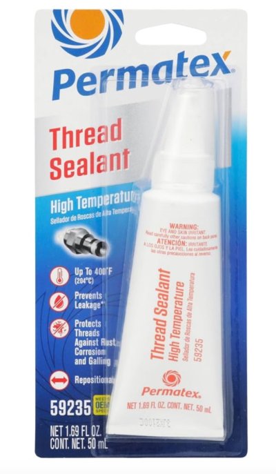

I’ve used the stuff pictured below on transmission drain plugs with good results. Wouldn’t hesitate to try it on a transfer case or differential plug. It’s like liquid teflon tape.

+1 on Teflon or something like Gasoila thread sealer. Gasoila stays soft/pliable and is made for petroleum based products.

I use Loctite thread sealant , I do live in gas and oil county so its available everywhere... lol..
