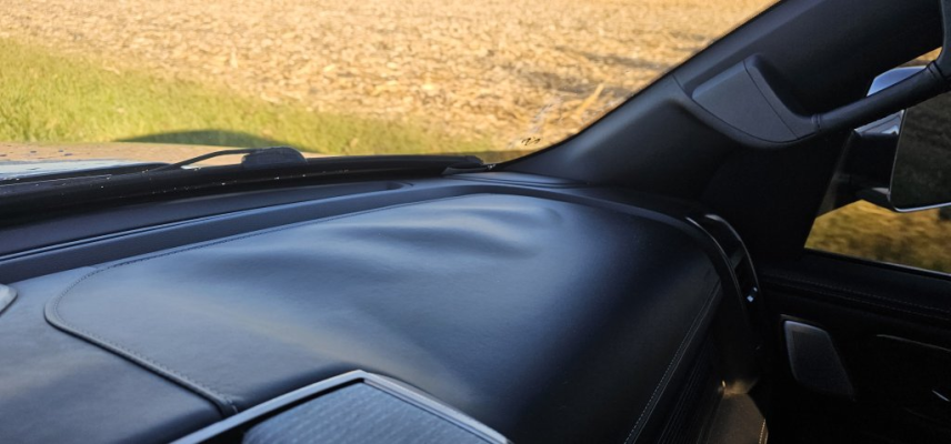

My 2019 Limited did the same thing. In 2023, At around 89K miles is started to get bad. I went to local dealer, who has been great, and they advised their territory guy who instructed me to open a Ram Care case. I gave the dealer the case number, who then gave it to the rep. I had my entire dash fixed at no cost to me. Ram covered everything. Call me lucky I guess. Sorry for those that I have read about, not getting support from their dealer or Ram. I love my truck, but my dealer has a lot to do with that.
This is what mine looked like
