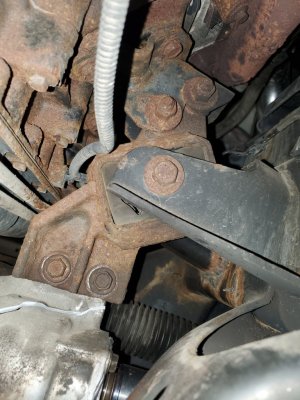

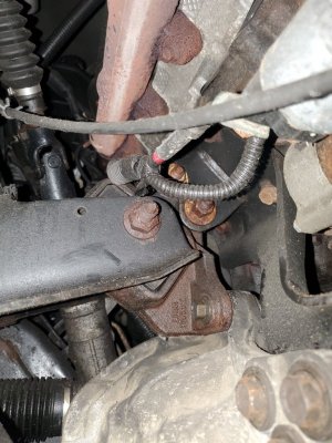

I checked all the bolts, would motor mounts do something like that ? I looked at them and the rubber seems fine, but it looks like its a little separated from the metal part of the mount, I don't want to throw parts on it until its fixed, Ill post pictures of the mounts today

I have no idea if bad motor mounts would do that but it doesn't hurt to check everything, even if it sounds obvious

you are right! Ill pull the mounts and inspect them!
