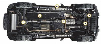

Your front driveshaft should spin (in sync) with your front wheels. Your ram does not have locking/unlocking hubs. It has unit hubs. The hubs spin all the time, the CV axles spin all the time, the front differential spins all the time, the front driveshaft should spin all the time.
When you put the truck in 4WD, the transfer case engages the front driveshaft, and sends power to the front wheels. When in 2WD, the front drivetrain spins freely, with no power. The fact that the driveshaft was not spinning in the beginning of the video, leads me to believe something is messed up inside the differential, or the transfer case.
In the video below, the driver has the vehicle in 2WD for the first 02:35.
To say it in a different way
In normal day to day driving the front driveshaft is disconnected at the transfer case. The front front driveshaft spins because the front tires are spinning and through the front dif are connected to the driveshaft. (new Jeeps have a disconnect in the front dif that is supposed to save some mpg). When put into 4x4, the transfer case connects the front driveshaft to the transmission. Think the transfer case as a 2 speed trans (4H/4L) that is in a pseudo neutral in 2 wheel. In non-electronic transfer cases you use a lever that is engaging the connection of the transmission to the front driveshaft(2w->4w). And at times, you can actually feel the gears engaging. And when using the electronic Xfer cases, when the 4x4 light is blinking, it is trying to synchronize the gears. When they are sync'd, the light stays steady.
In your vid I noticed that it started when the wheel went from turning left abit and a kinda sharp back to straight. I might be imaginating that though.
pic is from a Jeep, could not find a Ram pic
