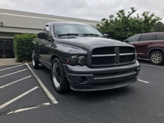

If you raise it, it will definitely have a negative effect towards the handling. Not saying it'll be totally ****, just not as good as factory.
Now if you lower it, correctly, it will dramatically improve the handling over factory. It'll handle like it's on rails then.
