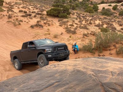

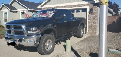

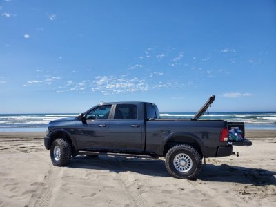

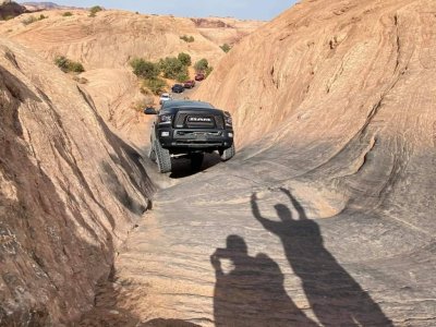

i would think with your 2.5 inch front leveling you should be fine to run 37's. I have a 2018 with the thuren 0.5 front leveling springs and 37's with a +28 offset aev salta wheel, slight rubbing on the driver side where my mudflap was. I heated the plastic fender liner and reshaped it enough to be out of the way and i pounded the pinch weld over. Here is a couple of pics in moab
View attachment 224625 View attachment 224626 View attachment 224624.View attachment 224624
Nice Climbing!! super sic
