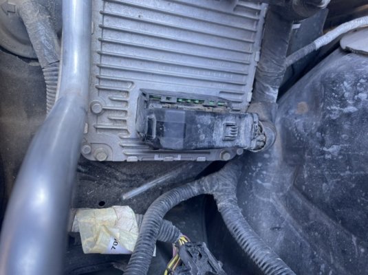

These brittle plastics on the electronics SUCK now the handle on one of the pcm connections broke.
For anyone doing this, just unbolt the 3 10mm bolts holding the pcm and take it off the firewall. It’s not worth futzing with the electrical connectors.
If the truck still runs,take it over to your local coin-op carwash and wash the hell out of everything under the hood ,then spray all your connectors down with WD 40 when you're trying to remove them. It's easier to take things apart when they're clean
Thanks for the suggestion…
I’m way deep already.

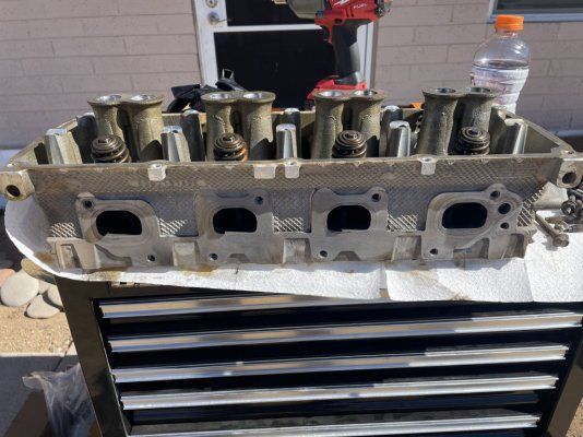

Passenger head is off. Scuffed the exhaust surface before lunch… will do some more after lunch to get them real and then ramflex gaskets and afe headers going on, followed by mopar performance springs.

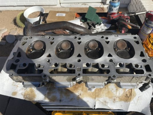

Passenger cylinder head surface clean (enough) after a laborious scrubbing with the scuff pad (ever with goo gone) finished with wd40 pass and wipe down
If you have a wire brush similiar to this one,chuck it in your electric drill and clean up the combustion chambers while the heads are off.Leave the old plugs in place while you do it.

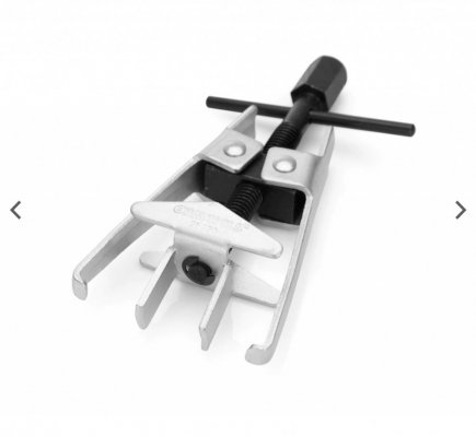

I’m still dealing with trying to finish swapping my springs since the stupid hemi specific tool stripped.
I rented the c clamp style spring compressor but the hemi springs are too close to the cylinder head wall for it to fully compress. I’ve tried a bunch of different angles.
Gonna have to go rent another style of compressor like this one I guess
I rented the c clamp style spring compressor but the hemi springs are too close to the cylinder head wall for it to fill compress. I’ve tried a bunch of different angles.
Is this the spring compressor you bought? If it is,you could drill it out and install a Heli-coil and then use a Grade 8 bolt instead of the probably Grade 3 or Grade 5 bolt it comes with

That tool works fine. Ive done 4 sets of heads with it. The only way it would strip is if someone used an impact on it. :cool:
I did buy the actual PowerHouse brand. Not sure on how the knoc offs would fair.

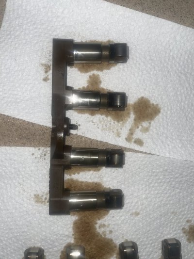

My passenger side lifters look fine
Sorry for the crappy pics I’ll take better ones tomorrow in the light
Yeah like that… it came with grade 8 bolt.
It’s getting returned I’m not keeping a $100+ tool that I have to fix to use.
And I did impact on it but only off , not tightening.
I’m just hoping that oem tools rental works otherwise I’m SOL for having my truck ready for Monday.
