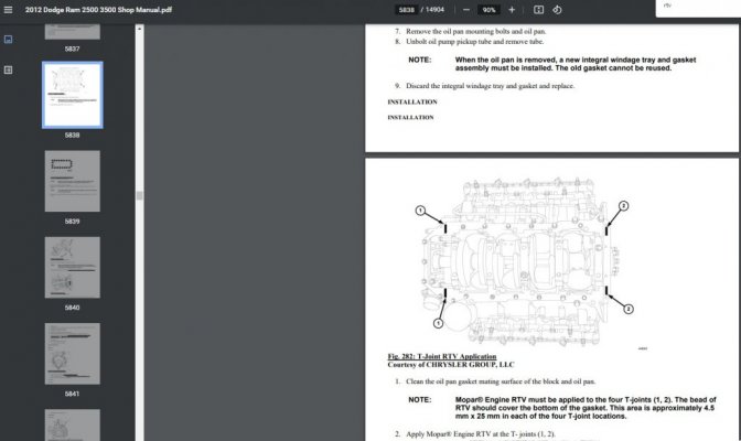

Does anyone use rtv when putting the timing cover back on? in the bottom corners of the timing cover / block/ oil pan? I’ve seen some people use it just dunno if it’s necessary or will create problems etc?
