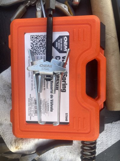

Aaaand this stupid thing doesn’t compress the spring enough for me to get the keepers in!
(Jaws aren’t long enough / stupid holder in the middle is too long to reach a lower coil on the spring.
Just ordered the powerhouse hemi specific tool from Amazon doesnt get here until tomorrow mf
Oh well guess I’m Ubering on monday.

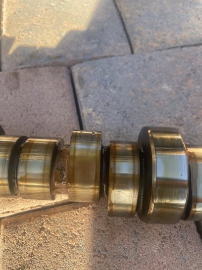

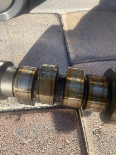

Ok vice grip on the lifter so it doesn’t just fall through, cam out corresponding lobe is wiped, with pitting on cylinders 4 and 2 as well.

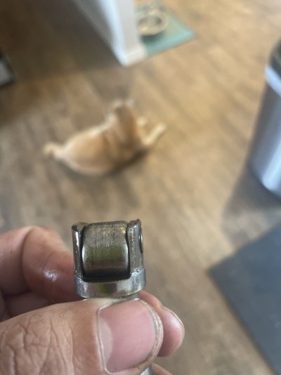

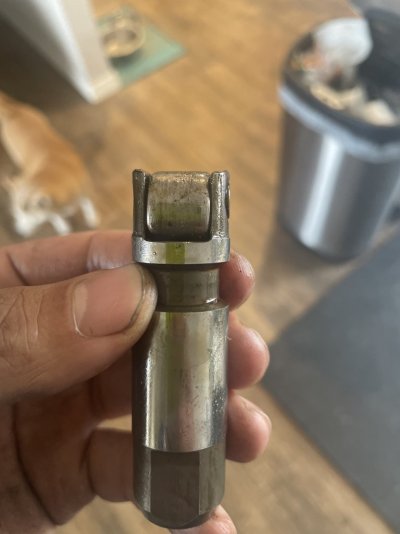

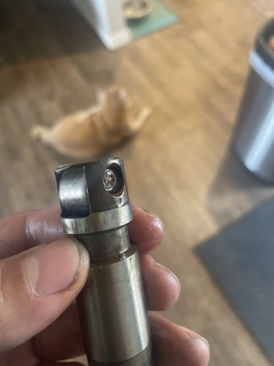

Success! Failed lifer out thanks to extending magnet and long piece of cardboard to stop it from falling down into the block. Pulled out through the cam opening.
Roller is completed frozen and worn with the pin staring to walk out
