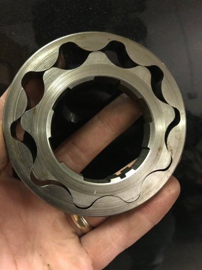

If the lifters and/or cam lobe(s) are worn down, where does the metal go?
Ive honestly always wondered how the prescribed fixed is ONLY replacing cam and/or lifters....how can one tell for sure the metal shavings didnt end up somewhere they arent supposed to be?

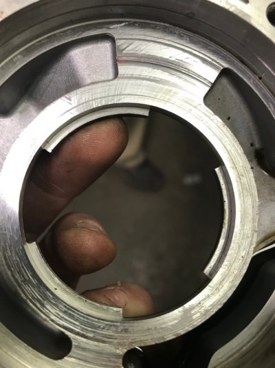

I have the oil pump pulled out of the engine I tore down with a cam/lifter issue. I’ll open it up and post pictures of any damage to it, I’m curious. When I had a a wrist pin come loose and damage the cylinder wall there was a ton of metal in there, here is the oil pump c190add85bc3f9e56089350e857f077c.jpg
