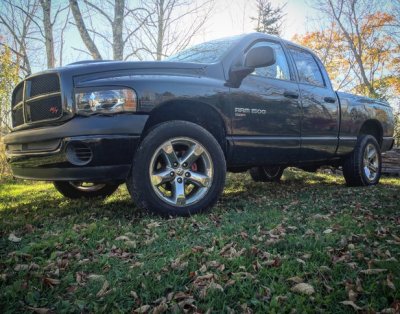

So I am looking into some nice tires for my summer wheels this spring, and I want to have a nice stance on my truck, without the "big lifted" look. I currently have the 08' model factory 20" chrome wheels, with 265/60R20 tires.
So I want to go with Toyo Open Country AT II's.
I want to go with a 295/60R20 , and I'm just wondering if these will work with my wheels and truck, without rubbing or anything. I'd like to keep the sidewall height but they also have the option for LT295/65R20, they also have 305 and 325 width, which I think would be a little too obnoxious, but I'm open to suggestions. I plan to have a torsion bar crank to level the truck out a bit, but other than that, no lift kits or anything.
Any suggestions would be greatly appreciated!

With a level, I believe that the trucks with T-bars (like yours) are able to fit 35/12.50R20s, so in theory you could run up to a 315/60R20, without rubbing. Now, every truck is different slightly from the factory, so you may have to trim a little plastic on the wheel wells, but that would be the most you'd have to do.
It's also highly recommended that you replace your shocks after you crank your T-bars, so I've read.

Okay thanks guys! I've been looking at the tire comparison diagram, and it isn't a whole lot wider, but I just want to make sure. I also plan on buying all new Bilstein shocks as well. I have tried searching for my particular wheel and truck with a 295 specific tire size, not much luck. I believe my factory wheels are 9 wide?
The tire conversion chart says 295/60R20 = 33.9X11.6R20, with a 11.6 width compared to my current 10.4.

I am running 33x12.50 on 20x10 wheels with a leveling kit on a 2017.
The guy I got them from was running bilsteins @ 2.1 I think. He now runs 295/60/20

I was running 305's for years on stock 20x9's, only reason I went back to stock size 275 was because I got a deal on a set.

No rubbing issues on the Upper control arms? 305 is quiet wide!
Only at full lock up front. If I were to do it again I'd have to check clearance on the rear since now I have inner liners.

305-55-20 work great for me fit wise

I rock 35/12.50/20 on my stock 20" clad rims, now I do have a 4.5" lift
