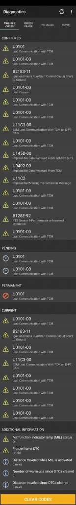

I having a no start issue. I replaced the battery, have tried getting a jump, and it still won't start. Any ideas?
Attached is a screenshot of some codes.

Do you have a volt meter to check actual battery voltage (low battery voltage will cause all kinds of issues)? Looks like all or most of those comm error codes are TCM related. Is it possible that the connection to the tranny controller got bumped when the battery was replaced (have no idea where the TCM is on a 1500). The BCM won't let the truck start if it doesn't see all the inputs it expects.
